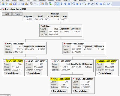

The following code helps to create new tables with good but only one selection can be chosen for bad population with the partition window open. I want the partition screen to be open but the user can select more than one leaf nodes for the bad population and rest will go to good population. Is there a way to do this?

I want to be able to select the yellow highlighted nodes as bad population and rest as good population keeping this partition window open and change the node selection if not satisfied with the result.
Is there some way to make it happen?

Here is a stab at it:

I might not have understood what you are trying to do and so I wont try and explain what is going on with the code - but if it is what you are trying to do I'm happy to give you an explanation of what's going on - just let me know.  Some of the code is a bit ugly but just wanted to see if I could understand what you were trying to do.  For my own convenience, instead of saving 2 tables to the desktop I create 2 (visible tables) titled 'selected' and 'not selected'.
