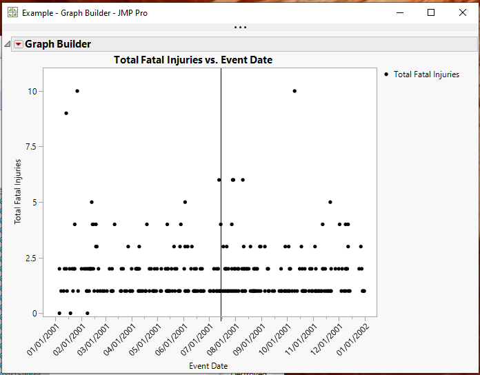

Hi, I'm trying to edit a graph builder script to use my table variables instead to plot the reference lines in the graphs. it's a plot of pressure drop vs dates. I have no issues with the y axis reference line, but the x axis reference line is giving me issues. I tried using the Date MDY() function to incorporate my table variables but it's not working.

Hi, x axis is a date/time column while y axis is a numeric continuous column. I plotted y vs x and saved the graph as a script. The reference lines were manually added inside e.g. y axis = 7, and x axis = 9/1/2023.
I then created a table variables called dp limit with a value of 7. I edited the graph script and replaced the reference line input to :dp limit, and it worked. So when I changed the dp limit variable, the graph reference line is changed. I can't do the same for the x axis reference line. It's a series of numbers in the script which I think is the date/time in seconds format. I'm not sure what I should input as a table variables for it to work. Hope this is clearer, thanks!

The table variable is a character string, as I mentioned before.  The JMP DateTime values are the number of seconds since January 1, 1904.  So before you can use the table variable, it needs to be converted into a DateTime value.  In the JSL below, I choose to use an Informat() function to convert the value.

gb = Graph Builder(
	Size( 531, 464 ),
	Show Control Panel( 0 ),
	Variables( X( :Event Date ), Y( :Total Fatal Injuries ) ),
	Elements( Points( X, Y, Legend( 5 ) ) ),
	SendToReport(
		Dispatch(
			"Event Date",
			ScaleBox,
			{Min( 3059894016 ), Max( 3093859584 ), Interval( "Month" ), Inc( 1 ),
			Minor Ticks( 1 ), Label Row( Label Orientation( "Angled" ) )}
		Dispatch(
			"Total Fatal Injuries",
			ScaleBox,
			{Format( "Best", 10 ), Min( -0.147373575211003 ),
			Max( 11.0505783676065 ), Inc( 2.5 ), Minor Ticks( 0 )}
gbr = gb << report;
refDate =informat(:Reference Date, "m/d/y");
gbr[axisbox(1)] << add ref line( refDate );

Thanks that solved my problem, I just added Informat(:variable) into the ref line input and that solved the problem
