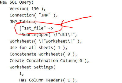

The above script works only if the file name is entered in the Query.
What if I want to run the same script on different files without changing the Reference Table name ?
Let's my 2nd file name remains constant and I want to perform similar operations on different files.
I have another excel file "3rd_file" and I don't want to change the name in the Query. Is there any Syntax which can copy the file name in the red circle part of the following image?
Any help/guidance is appreciated.
