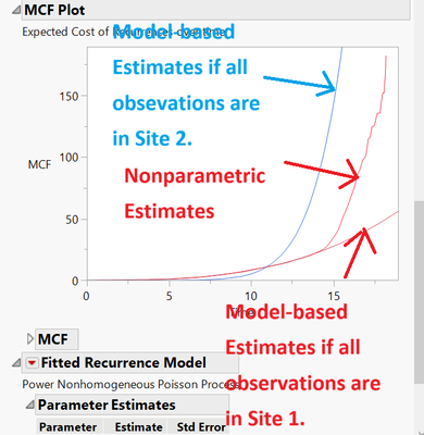

The nonparametric estimates in the MCF Plot, which is the first plot you see before fitting the model, does not consider the time varying covariate. And,the curve estimated by the model shows the curve when all time-varying covariate are fixed to each Site value. So, we cannot use the MCF plot to check the model is fitted well or not if your model has time-varying covariates.
The following script shows a simple toy example. In this simulated data, the scale (theta) and shape(beta) parameters are changed after the first 30 time points. The Site variables shows the change, and this Site is the time-varying covriate.  Just only for simplicity, I use Power Nonhomogeneous Poisson Process.
The time-varying covariate, Site, should not be included in the Grouping column.

In this simple toy example, the true model is fitted. So, the model fit is very well. But the MCF Plot cannot show the goodness of fit.
In short, do not inlucde time-varying covariates in  the Grouping column, and do not use the MCF Plot to check the goodness of fit if your model has time-varing covariates.

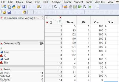

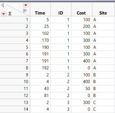

The next step is to see the COST (actual money) in the MCF to see the average money per bot repair.
So I am planning to put the money amount instead of the 1(indicating repair) in the cost role column. The 0 will still be kept to indicated censor status.
It that the right way to study average money per bot repair? Following is the data sample with actual money in Cost role column.
I am using JMP 18 standard.
Thanks.

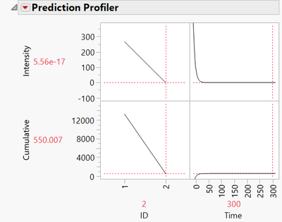

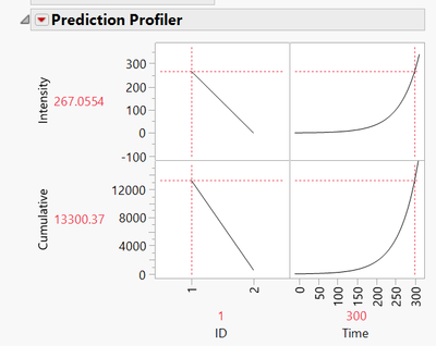

Re: Recurrence Analysis in JMP 18 Standard
Thank you again for your reply, @Caozheng0115 -san
You can specify any positive costs. In non-parametric estimates, the cumulative costs are calculated. In parametric estimations, costs are used as weights for log likelihood function. (If you would like to know the mathematical details, I would like to explain it more, so please reply so.)
I am very afraid that I misunderstood your situation and that I might have failed to explain "time-varying effect". In your last example, the "Site" column is not "time-varying effect". "Time-varying" effects are effects whose values changes within each ID. In the following data, the Site column is a time-varying effect.
I am also afraid that I misunderstand the difference in robots. I assumed that all robots are the same version, type and grade, so I did not set the "ID" as a grouping effect or a model effect. (For example, if ID=001, ID=002 and ID=003 are C-3PO, R2-D2 and BB-8 in Star Wars, respectively, these three robots are completely different kinds. So, I think we should set the ID column into Grouping column and also include it to a model effect.)
In your last example, the "Site" is completely confounded with the "ID". So, we cannot separate the effect of Site from ID. (For example, C-3PO worked only in a desert, R2-D2 worked only near sea, and BB-8 worked only inside a comfortable building, we cannot separate the ID effect from the place effect.)
Although I must still misunderstand your situation, the following is an example of an analysis for your last example. I calculate the nonparametric cumulative costs for each ID=001 and 002 separately by including the ID to Grouping column. I exclude data for ID=003 from my analysis because there is only one failure. I fit the parametric Loglinear Poisson process model for each ID. Based on this model, the cumulative cost at Time=300 for ID=001 is estimated to 13300.37, and the one at Time=300 for 002 is done to 550.007.
I attach the data table, your last example, which I used for the above analysis.
