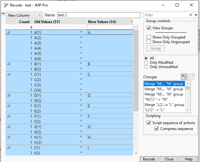

I created a new column in a data table with the test values you had in the JSL you provided.
I then opened the Recode dialog and made the recode changes.
I then went to the red triangle and selected
     Script=>Save to Script Window
and below is what it gave me.

In the example, you can see how the values are set for each of the value/result pairs
