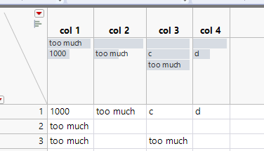

If run the example I gave with this data table:

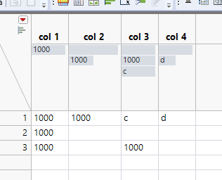

I end up with this
Here is updated example with new table and more columns added to ColNames list
Names Default To Here(1);
dt = New Table("Untitled 2",
	Add Rows(3),
	Compress File When Saved(1),
	New Column("col 1", Character, "Nominal", Set Values({"1000", "too much", "too much"})),
	New Column("col 2",
		Character,
		"Nominal",
		Set Values({"too much", "", ""}),
		Set Display Width(65)
	New Column("col 3", Character, "Nominal", Set Values({"c", "", "too much"})),
	New Column("col 4", Character, "Nominal", Set Values({"d", "", ""}))
wait(1);
    //Create list of columns to be recoded
ColNames = {"col 1", "col 2", "col 3", "col 4"};
For Each({listitem}, ColNames,
	dt << Recode Column(
		//As Column(dt, listitem),
		As Column(listitem),
		{Lowercase(_rcNow), If(Contains(_rcNow, "too much"),
			"1000",
			_rcNow
		), Regex(_rcNow, "\D*(\d+\.?\d*)\D*", "\1", GLOBALREPLACE)},
		Update Properties(1),
		Target Column(Column(listitem))
-Jarmo
