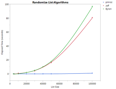

Very interesting.  My table solution seemed kind of brute force but it outperforms the other two functions when the number of list elements gets above 15,000.  Table functions are very efficient apparently.
Here's the code I used:

Craige_Hales
Re: Randomize a List
the results will change in JMP 13.
Fast List
400,000 looks like this in JMP 13:
"pmroz: 0.533333333332848"
"Jeff: 0.233333333333576"
"Byron: 0.216666666667152"
Craige

Table functions are very efficient for large data sets.  One of the main reasons is b/c JMP takes advantage of multiple cores while JSL does not.  However, for small data sets the process of creating the table adds a lot of overhead.  For the application I am using this for, I actually had something similar to PMroz's answer, but since my lists were all <1000 items, I noticed it was adding quite a bit of time.
Thanks Everyone!
Note: Today() is only accurate to the second, Tick Seconds() is accurate to 1/60 of a second, and HP TIME() is accurate to the microsecond.  Of course, this all depends on your computer.  Also, to give a fair advantage, I changed your tables to private, and removed the close statement, which will speed up your script.
