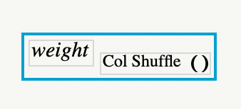

Re: Random subset selection for a given distribution
You have got to be kidding me.  Getting a random sample from another column, and showing it to you in a separate column, is a menu selection in Minitab.  The answer to this took two pages of discussion and dozens of lines of code.  Why are simple things so difficult in JMP?
Jeff_Perkinson
The original request here was not for simple random sampling of another column.
If that's all you need you can use the Col Shuffle() function to generate a new column with random selection from another.
-Jeff
