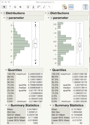

Oct-16-2018 17-53-15.gifDepending on your purpose getting a subset like this may be statistically questionable but one way to do it is to brute force it by using Resample Freq() to generate random samples and then checking that sample to see if it meets your desired characteristics. Here's a prototype that generates a table to simulate your original data and then resamples it, uses the Distribution platform to test the sample.
dt = New Table( "original",
	Add Rows( 1000 ),
	//:parameter will have a random normal distribution with mean=0
	//and a stddev=1
	New Column( "parameter",
		Numeric,
		"Continuous",
		Format( "Best", 12 ),
		Formula( Random Normal() )
	New Column( "Row", Numeric, "Continuous", Format( "Best", 12 ), Formula( Row() ) ),
	//The Resample Freq() function generates a frequence count for sample with replacement
	//the .05 argument is the sample rate, i.e. we want a sample size of 5% of the original table
	New Column( "Resample Freq",
		Numeric,
		"Continuous",
		Formula( Resample Freq( 0.05 ) ),
//Generate a distribution of :parameter using the resample frequency as a Freq column to get
//Automatic Recalc will cause the Distribution to rerun when the Resample Freq column is re-evaluated
//to get a new sample
New Window( "Dist comparison",
	H List Box(
		dt << Distribution( Continuous Distribution( Column( :parameter ) ) ),
		dist = dt << Distribution(
			Automatic Recalc( 1 ),
			Freq( :Resample Freq ),
//set the minimum mean value we will accept for the subsample
target_mean_min = .249;
target_mean_max = .251;
//how many iterations are we willing to try before giving up?
max_iter = 1000;
iter = 1;
While(
	//Report( dist )[Number Col Box( 2 )][1] is the mean value from the Distribution report
	!(target_mean_min <= Report( dist )[Number Col Box( 2 )][1] <= target_mean_max) &
	iter <= max_iter,
	//get a new sample
	Column( "Resample Freq" ) << eval formula;
	iter++;
If(
	//check to see if we exited because we hit max_iter or got a good sample
	iter > max_iter & !(target_mean_min <= Report( dist )[Number Col Box( 2 )][1] <=
	target_mean_max)
	Print( "No result in " || Char( max_iter ) || " random samples." ),
	//got a good sample so get the subset
	dt << select where( :resample freq != 0 );
	dt << Subset( Selected Rows( 1 ), Selected columns only( 0 ) );
-Jeff
