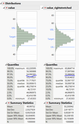

Maybe this could be a way to do this, see the JSL script.
As @P_Bartell pointed out already, we need a lot of more rows to see exactly (2 digits or so) the numbers you want. And we need to manipulate the distribution to show that values you want (unsymmetry).
The stretching did change the mean by 0.2, this I did not account for ...
Of course you could calculate 100 rows only and manipulate them i a way to get that exact numbers you want ...
Or you can work with random seed, to generate exactly the same random numbers next time.
You see, JMP can do it all ..., welcome to the community.
Good luck.
Names Default To Here( 1 );
// Generate data with 95 % Confidence between 45 and 56 with mean of 50
// returns the probability that a normally distributed random variable is less than q (45)
Normal Distribution( 45, 50, 5 );
// 0.158655, i.e. roughly 15 % of values are below 45 for a normal distribution with Average=50 and sigma=5
// Returns the quantile from a Normal distribution, the value for which the probability is p that a random value would be lower
quantile = Normal Quantile( 0.025 );
// -1.959964, i.e. 2.5 % of the values are below -1.959964, or smaller than Average minus -1.959964*sigma
// we need this quantile and have the absolute difference 2.5 % left + 2.5 % right = 5 % out, i.e. 95 % in
sigma = Abs( (50 - 45) / quantile );
Normal Distribution( 45, 50, sigma );
// 0.025, this is what we want
// now we can generate a table with that distribution
// and will scale the upper half by 6/5 to have the probability of 55 at 56 in a second column value_rightstretched
dt = New Table( "random confidence 45 50 56 95%",
	add rows( 1000000 ),
	New Column( "value", set each value( Random Normal( 50, sigma ) ) , Set Property("Spec Limits", {LSL(45), USL(55), Target(50), Show Limits(1)}),),
	New Column( "value_rightstretched", formula( If( :value > 50, (:value - 50) * 6 / 5 + 50, :value ) ) , Set Property("Spec Limits", {LSL(45), USL(56), Target(50), Show Limits(1)}),)
dt << Distribution(
	Continuous Distribution(
		Column( :value ),
		Outlier Box Plot( 0 ),
		Process Capability( Use Column Property Specs ),
		Customize Summary Statistics( Set Alpha Level( 0.01 ) )
		Column( :value_rightstretched ),
