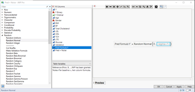

  If you have measurements on multiple batches that were made under same conditions/recipes, then you should already have a good estimate of the batch to batch variation. Also, if you have multiple measurements on a single batch, then you should also have an estimation of the noise from the measurement system itself.
  From that, once you have your prediction formula, you can create a new column formula that is the prediction formula plus a normal distribution that is centered at zero with a standard deviation that is the square root of the batch to batch variance plus the measurement variance.
  It should look something like below -- I  just used the Diabetes.jmp file to create an example prediction formula and then added a Random Normal (mu,sigma) function to add noise. This would add a normally distributed random number with mean 0 and standard deviation sigma to your prediction formula.
