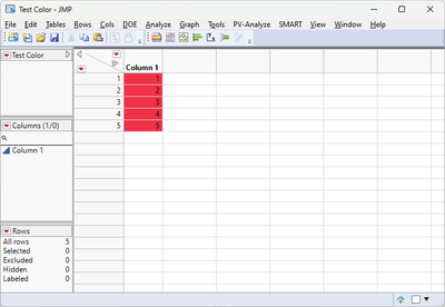

pmroz
Re: RGB color by sript
Rather than use "get rows where", might be easier to create a matrix of all row numbers.
dt = New Table( "Test Color", Add Rows( 5 ),
	New Column( "Column 1", Numeric, "Continuous", Format( "Best", 12 ),
		Set Values( [1, 2, 3, 4, 5] ) )
// Create a matrix of rows 1 to n
rows_to_color = 1::nrows(dt);
// Set the color
dt:Column 1 << color cells("Red", rows_to_color);
