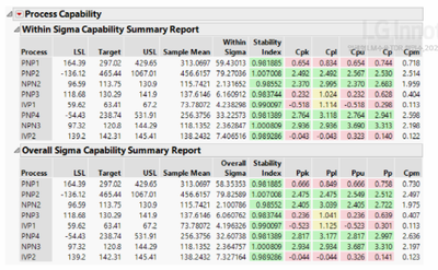

I would like to ask some questions for the process capability (Analyze - Quality & Process -  Process capability)
I have made an summary report & have 2 questions during the process
1. Why should I set alpha level (Significance level)? What does this value mean here? What does it impact for the result?
Actually I changed the value, but cannot find the result changed
2. I could see colors are in the cpk values. I guess Cpk 1.33 is spec & when the value is less than it, yellow color pops up
& less than 1, red color pops up.
Where can I change this color spec?
Thanks!!

https://www.jmp.com/support/help/en/16.0/?os=mac&source=application&utm_source=helpmenu&utm_medium=a...
Specifies the significance level for confidence limits.
Often you can change colors schemes in the preferences and sometimes there are options in the preferences>platforms, but I don't use this platform, so I'm not familiar.
Re: Questions for the process capability (Analyze - Quality & Process -  Process capability)
To alter the color scheme, choose File->Preferences.  Select Reports on the left.  On the right, click the Manage Rules button.  Choose Capability Index and click Edit.
