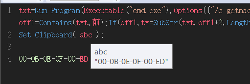

Get the machine code of his MAC card for JSL like this
txt=Run Program(Executable("cmd.exe"),Options({"/c getmac"}),Read Function("text"));Set Clipboard( txt );txt = Regex( txt, "[\n\r]", "\!n", globalreplace );txt=Substitute(txt,"\!n",""," ","");前="==00";off1=Contains(txt,前);If(off1,tx=SubStr(txt,off1+2,Length(txt)));后="\Device";off2=Contains(tx,后,-1);If(off2,abc=SubStr(tx,1,off2-1));
Set Clipboard( abc );
