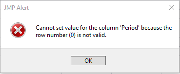

A last question, last question. I often have this type of error :
My Period column is made of "Previous", "Current" and "Next" elements.
How can I fix this error ?
Thank you very much !
Jean
Re: Questions about control charts
Typically this issue is encountered when there is a column and a JSL variable with the same name.  While possible, it just means that you have to be specific in the code. So be sure you are using proper scoping so that JMP understands whether you meant the JSL variable or the column.
