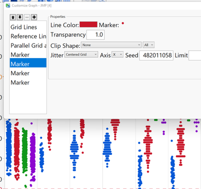

 I'm unable to set the color for an indivdual variable in my graph using the customize feature. I was able to do this in JMP 14 but now with JMP 16, I'm unable to use this to set different colors for variables in the same graph. Examples provided as snapshots below.
 Currently, in version 16, if I select customize and go the marker option to select a color it changes all variables (markers) as the same color. I would deeply appreciate the help if you know how to resolve this. My JMP 14 license will expire soon and all my previous analysis will not carry over in JMP 16.
Thanks,
 Naeem
In JMP 16 I am unable to select individual colors for markes. If I select a color it applies it to all markers.
In JMP 14, I can use this same feature (Customize Graph) to set different colors for my variables.

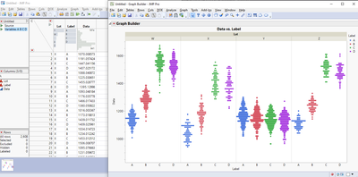

Could you possibly stack the data and then use Label as color property?

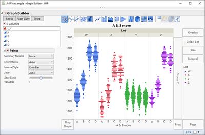

It would be helpful if you could attach your JMP file...It looks like you are using Graph Builder.  There are many options for customizing the markers and colors.  In graph Builder, drag what ever you have along the X-axis into the color box on graph builder.  Also, right click in the graph gives you many customizable options.  I assure you that you can create what you did in JMP 14 in JMP 16...

pmroz
Re: Question about JMP 16 graph color customize option
I dragged the Lot column to the Color role.  Is this what you want?

jthi
-Jarmo
ndowidar
Level III
Thanks! I've never stacked data before, but that graph looks like what I want! Although, I just wish there was that easier feature included from JMP 14.
 Thanks again for showing me a way to make it work. If you find another option let me know. Much appreciated!
