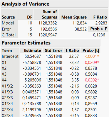

Re: Query on generating DOE with four (2-level) variables and analyzign 2 variables at a time
Hmmm, Victor, not sure what you mean? JMP will create the full model. While the default order for JMP macros is 2, that does not mean JMP assumes a model with up to 2nd order effects.  You just have to change the degree.
Again, while you may believe the higher order effects are negligible, you are pooling those effects to estimate the error.  In fact, if you believe the higher order effects to be small, you are biasing the errors and therefore biasing the statistical tests. This error estimate is not the same as "pure error".
