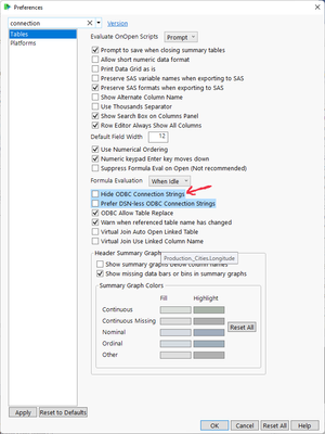

Hey everybody,
everytime I save or run a Query Jmp deletes in the script the lines referencing the Database. (The highlighted lines in the attached image.) I have to insert them by hand when I want to use the script again. I haven't had Jmp long, but it wasn't like this at the beginning, and I would prefer if Jmp didn't delete it.

Do you have the "Hide ODBC Connection Strings" option checked in the preferences?

Yes it was. Thank you!
