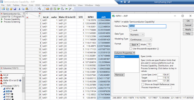

Hi,
I am wondering how to use the setted spect limit data (Target) in formular?
For example(attach file):
The Column "NPN1" already setted USL/LSL/Target, and I would like to calculate (NPN1-Target) in the new column "shift"
How can I directly use (NPN1-Target) in formular instead of use (NPN1-118.15)? Thanks.
Regards,Chily

Here is one way to write the formula
As Constant( target = (:NPN1 << get property( "spec limits" ))["Target"] );
:NPN1 - Target;
Jim
