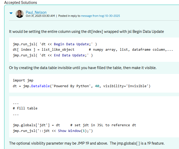

One of my colleagues pointed out in JSL there is the Start Data Update and End Data Update, so....
jmp.run_jsl( 'dt << Begin Data Update;' )
# your python code filling new column
jmp.run_jsl( 'dt << End Data Update;' )
Most likely we will want to do support this from Python. Probably using a with block to suspend the UI updates of the table when filling / updating large number of rows.

Re: Python in JMP: dataframe column to datatable column best practices and computation speed implications
Yes, this is significant.  We are indeed looking at a fix.  We want the performance from Python to be such that users want to run from Python and not have to use backdoor magic methods to get performance.
I'm surprised this didn't show up in JMP 18 or during JMP 19 EA testing.  The jmp.DataTable object at its heart is the JSL datatable.  The Python object is just a reference to the underlying JMP DataTable, and we are calling the JMP Data Table's internal methods, which is why the run_jsl( 'dt << Begin Data Update') makes a difference.  The entire reason for the jmp.run_jsl(''' code '''') was to allow calling JSL from Python for things that we have not yet implemented, or as in this case rectify an oversight on column update performance.

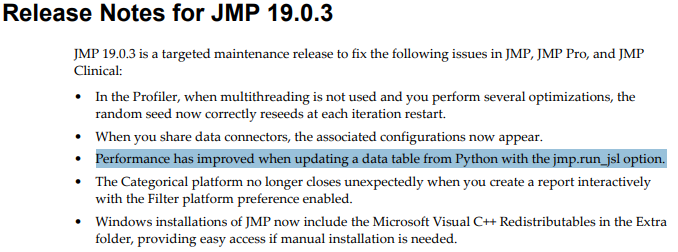

Info shared in today's Scripters Club:
the speed issue with
dt[ index ] = list_like_object
 will be fixed in JMP 19.0.3     :  )
Available now:
