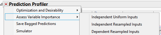

When you say, "running the profiler and subsequently the importance ranking gives another ranking of the predictor variables," are you referring to using one of the Prediction Profiler commands shown here:

Yes, I do
