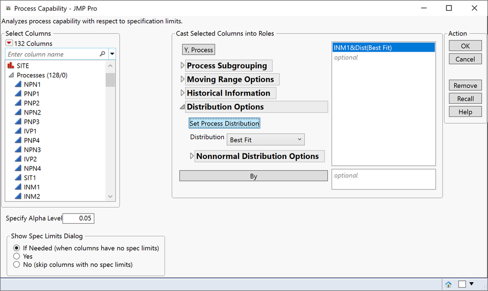

The dialog for Process Capability is a bit strange.  You can select the distribution type, or select best fit but you then need to make sure you click 'Set Process Distribution'.  This will be confirmed by the variable name having an &Dist suffix:

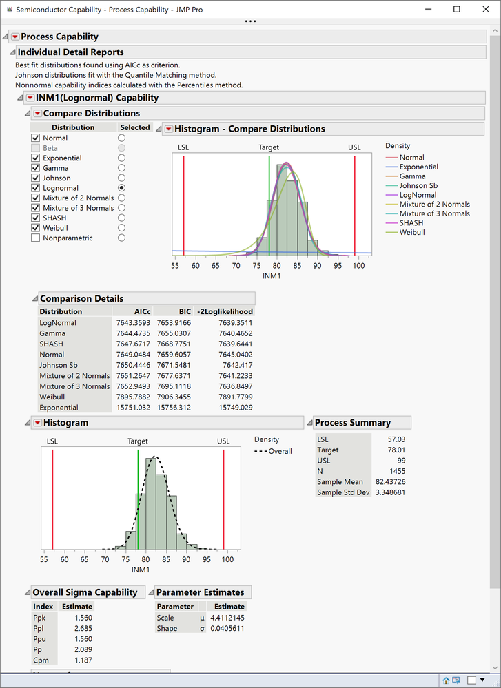

Here is the output if you select 'best fit'

Hi Dave,
Thanks for the trick. It worked for me so that I can see the best fitted distribution and ppk in the summary page.
