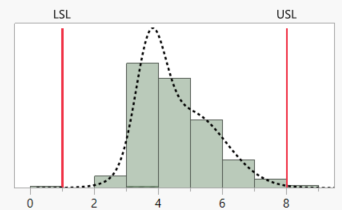

Hi,
I have calculated the process capability in JMP for this process with the mixture of 2 normals distribution. Our current ppk is 0,94. We plan to improve the measuring system cause it has currently a high variation. Now I want to explore how much improvement for the measuring system is needed (measuring system variation is actually 2.5).
Does anybody know how this simulation can be done in JMP?

The total variation you are seeing in your histogram is Variance(total)=Variance(part)+ Variance(Measuement system[MS]).
If you know the variance of the MS as well as the total you can solve for the variance of the part.
From that you can then create a random data column where you create a fake data distribution based upon your new variance total where you use the previous calculated part variance and the estimated new MS variance.  You could make multiple columns stepping down the MS variance and then use the process capability platform to look at all the different step downs and see what amount would be needed to reach a desired Ppk.
Hope this make sense!
