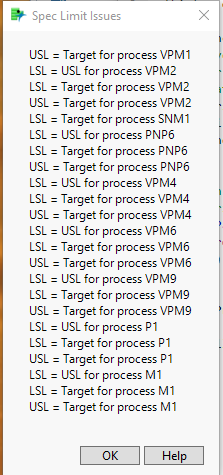

  2. Not all of the columns have both USL and LSL assigned

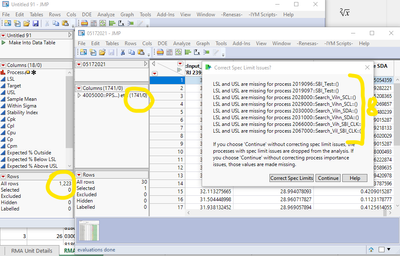

thanks for the reply jim.  i'm not sure what i'm doing wrong with this one.i tried to do it manually but it still looks like its skipping about 200 processes. there are some process limits missing about 8 from what i see. however the summary comes in with  more than 518 missing including 6 that are missing limits
Total processes: 1741
Total no limits : 8
Total Process in summary: 1223

My examination of your included data shows that 248 columns that are not analyzed in the Process Capability platform are being excluded because they have zero for all of their rows.
