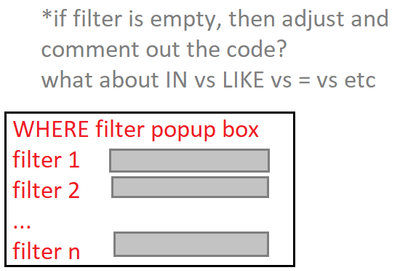

So I'm using an ODBC to connect to SNOWFLAKE and run some scripts. Wondering how I can set up a UI window w/ a list of WHERE filters to make it easier for ppl to use.
I'm envisioning a list with popups to then map to a variable to feed into the SQL script. possible?

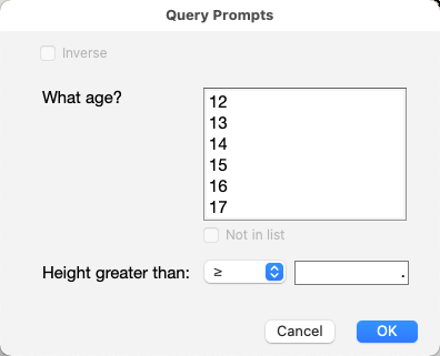

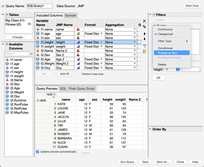

Jeff_Perkinson
Re: How to create user inputs for SQL where filters?
This is easily done with the SQL Query Builder.
In the Filters there's an option in the Filters to Prompt on Run and JMP will prompt for you. No need to build your own dialogs.
Read more and walk through an example in Build An SQL Query.
