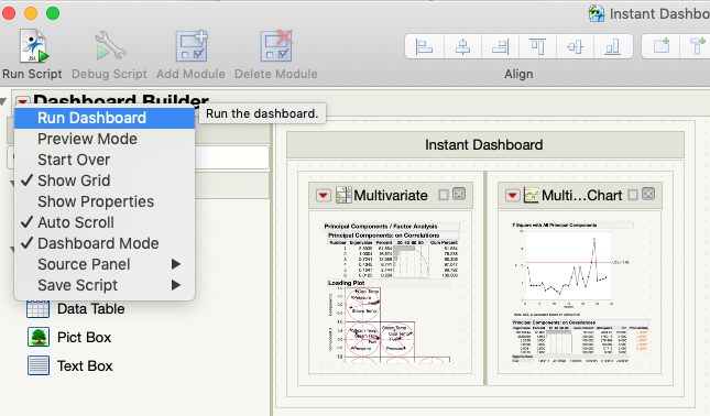

Be sure to run the dashboard and then proceed with the sharing.
Run DashboardRun Dashboard

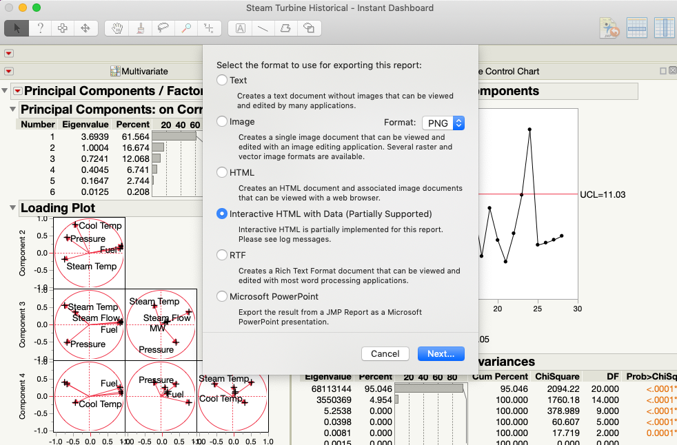

From within JMP ensure your dashboard is the active window and then Select File > Save As and select Interactive HTML with Data from the Save as type list.
On Macintosh, select File > Export > Interactive HTML with Data.
 File >> ExportFile >> ExportSelect Interactive HTMLSelect Interactive HTML
