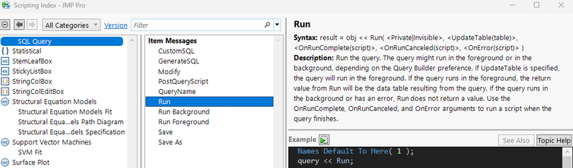

Re: Problem calling a script with Include()
One other thing to check: queries can have different timing behavior when running in the background or in the foreground. Sometimes explicitly using Run Foreground can be helpful.
