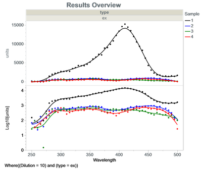

Also, i tried setting this up in a graph in the proper way (grey font instead of black) and saving the preset. However, if i add more axes (second Y axis, a "page" variable etc.), i see that the setting applies to the first axis only and does not translate. I specifically do not want to link axes, which is an option in the platform preference. The preset also saves the graph type, which i do not want.

basically, i want the colors to stay grey, if users change anything (this just as an ugly example):
