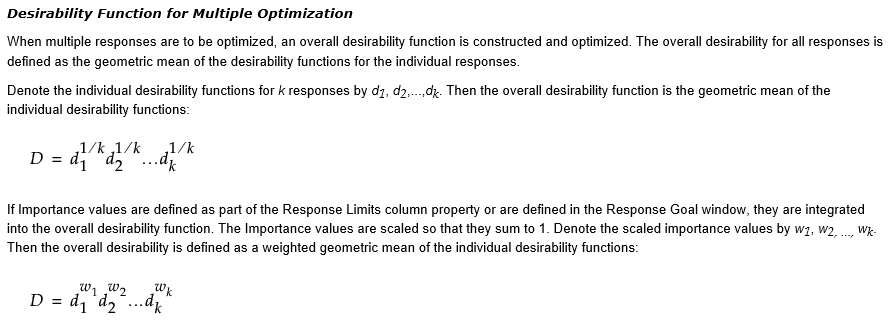

I just want to add to Ian's explanation that you should not use large numbers like 10 or 20. Such a value will practically eliminate the responses with an Importance value of 1 from the optimization.
From JMP Help:

Re: Prediction profiler Importance rating
From JMP Help:
