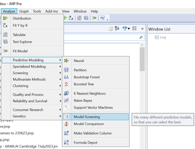

Hi @ChristerMalm ,
Go to Help > About JMP. Check that you have JMP Pro. It may be that after re-installing the software it got associated with a license key for standard JMP. Your IT / JMP Administrator should be able to help there.
I assume you are asking about Model Screening which you will find in Analyze > Predictive Modeling:
I hope this helps,
Phil

Hi @ChristerMalm ,
I hope this helps,
Phil
