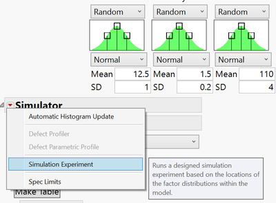

It sounds like what you want to do is a "Simulation Experiment". There is a capability for this in the Simulator in the Prediction Profiler:
However, this uses a space-filling design across the factor space, rather than fixed values from a table. But it might be a good idea to first see if this enables you to answer the scientific/engineering questions that you have.
I feel like there should be a way to use your table of fixed values but it might be a bit more complicated.
