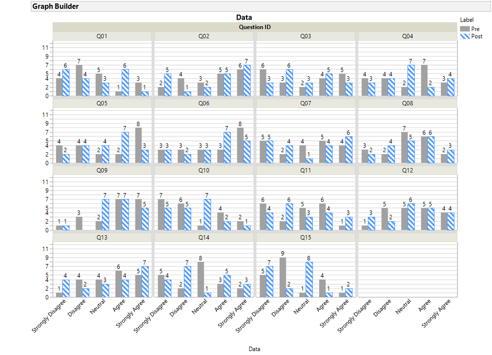

I am looking for a way to show pre- and post- survey questions next to each other in a bar graph. The possible responses (strongly disagree throuhg strongly agree) should be in the x-axis, and the number of recipients responding in each of those catagories should be in y-axis. However, I want to show the values of each response value next to each other to show the before and after affect of the exercise. I can get the groups next to each other with graph builder, but I can't get the "strongly disagree" values to be grouped together, etc. Any help would be greatly appreciated.

This would be easier to answer is there were more details, for example what do you mean by groups? Groups of questions or groups of respondents.  Often it is easier to arrange bars when the data is stacked.
If you can show the layout of your data without showing the specific values that would be helpful.
gzmorgan0
Super User (Alumni)
Re: Pre/Post-Survey Bar Graphs in JMP
Below is a script that generates a table simulating data for 15 questions, three for each of 5 topics and 20 respondents. I have no idea how your data is organized. Thsi table has 300 rows (20 x 5 x  3), identifier columns (Respondent, Question ID, Gender, Topic, Pre and Post).
So that the pre/post bars can be side-by-side, the data needs to be stacked, in other words, Pre/Post is a label for each response.
Below is one display/example display. The script to generate some data, stack the data, then create this graph is below the picture.
