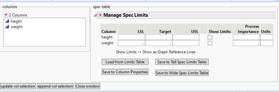

hello,
I have a script that will bring up a column dialog and the manage spec limit platform.  I'd like to be able to click the update button and have the manage spec limit table reflect the selected columns.  I have not be able to figure this out so the work around is to have the window close and then reopen calling some global variables.
Can anyone propose a less cumbersome way of accomplishing this?
Thanks for any ideas!

I would do this by removing display box and then appending it again with new column list. The most difficult part is most likely getting the old list of columns in Manage Spec limits (and removing duplicated column names), below is one option what you could do:

That works great!  Looks like I need to understand  "append" better.  Also, you are correct, I need to add in a check for duplicate items and remove them.
