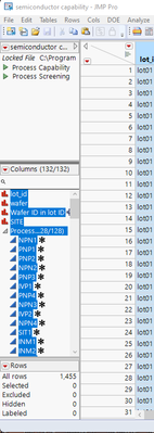

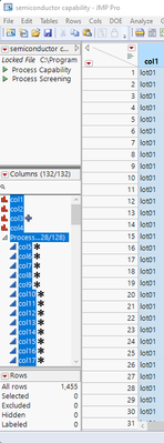

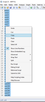

One interactive way to do this, is to copy all of your new column names into the paste buffer.
Then select all columns from the Columns Panel in your data table.  I suggest that you use CNTL/a to select them all
And then use CNTL/v to paste from the paste buffer to the column names
Jim
