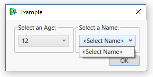

      I found this post and example very relevant to my needs. https://community.jmp.com/t5/Discussions/Creating-drop-down-menu-for-interactive-user-input/td-p/179.... However, as I try to implement/execute the code piece provided here, I don't see what I expected to happen. I think it is a typo, provided is my edited - working code.
dt = Open( "$SAMPLE_DATA\Big Class.jmp" );
/* Extract a list of unique ages */
Summarize( a = By( :age ) );
Insert Into( a, "<Select Age>", 1 );
/* Create a modal dialog */
New Window( "Example",
    <<Modal,
    H List Box(
        /* Upon selecting an age, populate the second ComboBox with corresponding names */
        Panel Box( "Select an Age:",
            cb1 = Combo Box(
                a,
                <<SetFunction(
                    Function( {this},
                        selection = this << Get Selected();
                        r = dt << Get Rows Where( :age == Num( selection ) );
                        ageNames = :name[r];               ///////////////////////////////// EDIT - Needs to be :name[r] and not :name
                        Insert Into( ageNames, "<Select Name>", 1 );
                        cb2 << Set Items( ageNames );
        /* Print the selected values from both ComboBoxes in the log */
        Panel Box( "Select a Name:",
            cb2 = Combo Box(
                {"<Select Name>"},
                <<SetFunction(
                    Function( {this},
                        that=this<< Get Selected();
                        Print( selection, that  )
sel=num(selection)
Looking at the code and reading through it, I was hoping once the user selects an age in the first Combo Box, the second Combo Box should be populated with the names of people with that age. However, I don't see that happening here with the original code. This above code fixes it.
Is this the best way to handle this - Or are there other options ?

The "Modal" window is not letting the flow of your code work.  If you change the window to a non modal window the code works as you described you want it to work..  I have added to your script to make it work the way you want it, without it being a modal window.
Names Default To Here( 1 );
Clear Symbols();
nw = New Window( "Example",
   // <<Modal,
	H List Box(
			cb1 = Combo Box(
				a,
				<<SetFunction(
					Function( {this},
			cb2 = Combo Box(
				{"<Select Name>"},
				<<SetFunction(
					Function( {this},
						that = this << Get Selected();
						Print( selection, that );
	Button Box( "OK", nw << close window; myPGM )
myPGM = Expr( sel = Num( selection ) );
Jim

@txnelson,
       Hello Jim,
             I could get the code sample from the other discussion  to work even  whille the window is Modal. The issue was in the original discussion, the code is not subsetting the selecting rows, which I added. However, I am wondering if this is the best way to do this or are there any better solutions ?
Best
