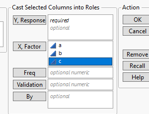

I am looking for a way to populate a collistbox from a list of columns in the clipboard.  I tried the getclipboard() command but since the list that is returned isn't a list of columns names this approach fails.
For background, I am copying a list of column names out of one datatable (the names are listed in the rows) and using the copied list of column names as the input for an analysis in another datatables analysis.
If I just open the analysis platform (NN) and right click on the X input box I can paste in the column names.
I'd like for the terms to show up in the second box:
So I'd copy the column names and run my script and the columns would be able to be selected in the optional box.
thanks for any ideas!

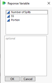

shampton82
Level VII
Re: Populate a collistbox from the clipboard
That worked really well!
I added your code to this and I'm good to go:
selCols = dt << Get selected Columns( String );
obj2=new window("Reponse Variable",
			<<Modal,
			<<Return Result,
			LineupBox( NCol( 1 ), Spacing( 5 ),
			choseny = ColListBox( dt, all, <<Set Data Type( "Numeric" ) )
			V List Box(
				chosenx = ColListBox(dt,<<append(eval(selcols))),
			H List Box( Button Box( "OK" ), Button Box( "Cancel" ) )
