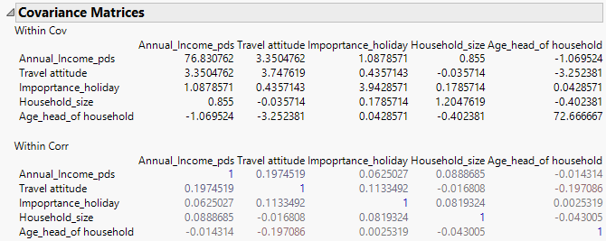

i am trying to locate where in JMP is the 'Pooled within-groups correlation matrix.'
I have looked at Multivariate and Discriminant  analysis. I can see the correlations and the correlation probability output. But i am looking for the 'pooled' within group correlation.
Anywhere i can go in JMP?

here you go. I have attached some screen shots and my JMP data.
most of the JMP data does not really match up well. Some do or come close.

Actually, you had the result that you wanted. Use Analyze > Multivariate > Discriminant. Enter the 5 covariates as Y and the visit as X. The linear discriminant function will provide a table if you click the red triangle at the top and select Show Within Covariances. You get the table that was shown in your Word document.
