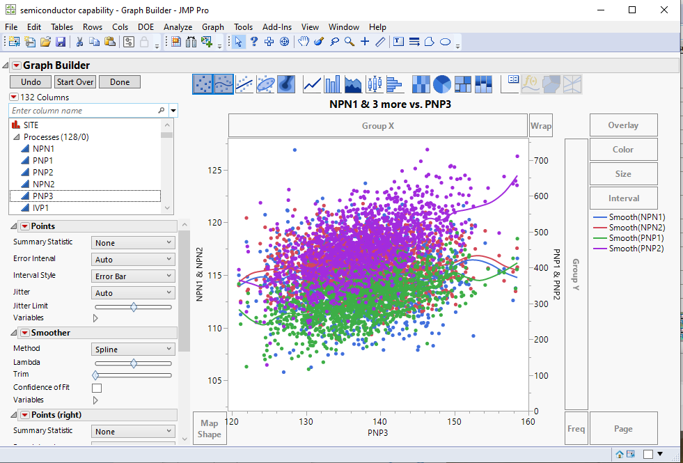

Graph Builder allows a large number of columns to be displayed on the Y axis.  It only allows the display of 2 different axes, left and right of the graph.  The various Y axis columns can be assigned to either the left or right Y axes

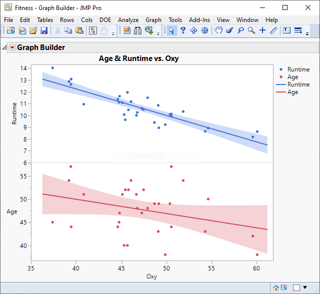

Is this examplegb.PNGgb.PNG what you mean by "different scales?"
FN
FN
Level VI
Re: Plotting several trends from sensor data that have different units (or scale)
Yes, the issue appears when you have more than two.
I have been using Graph Matrix under Dialog, but I was wondering if several axis could be combined into one.
