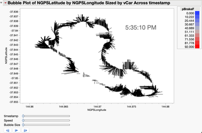

I did something like that where I wanted the g-force vector plotted for every location along a race track.
To get the lines, I added a customize script to the graph like this:
Pen Size( 1 );
For Each Row(
	Line(
		{:NGPSLongitude, :NGPSLatitude},
		{:NGPSLongitude + :gLong / 2000, :NGPSLatitude + :gLat / 2000}
I've attached the data file below. The first script (bubble plot 3) has the figure above.

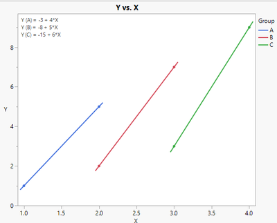

Re: Plotting multiple short lines using only points and slopes
Except for me not understanding what you mean by the lines being " half the distance...", another way to do this would be to create 2 new formula columns to find one more X and Y point, then do some table stacking and splitting to create graphs for each group, basically just fitting a line to each of the (now) 2 data points. I've attached a workflow (for which you need JMP 17) to demonstrate this. If you need the script, let me know, and I'll send it along. Output below:
