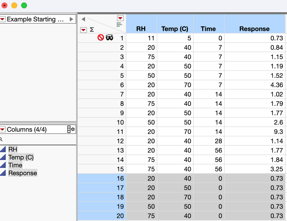

 Pretty common data prep step for stability data at multiple storage conditions.  As described below, the general procedure to do this is:
  1. Summarize the storage conditions into a separate table.
  2. Past those conditions at the end of the original table, and set the time point for those rows to be the initial time point.
  3. Calculate the average response(s) at the starting time point, and use that value for all the pasted rows above.
  4. Delete or Hide/Exclude the original initial timepoints from the data table.
I just happened to recently finish a script to help automate this (provided with no guarantee or warranty).

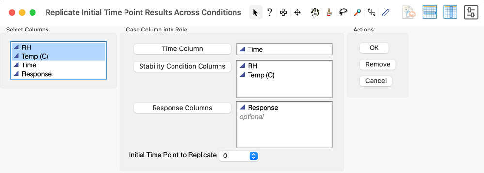

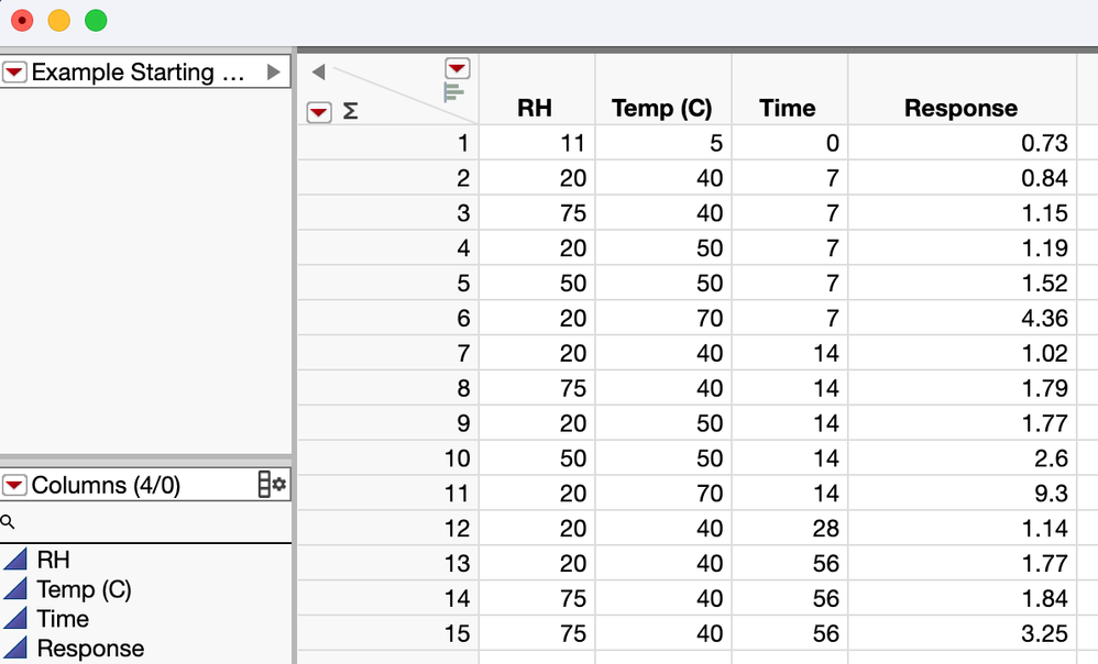

Example: (also attached)
Dialog:
Result:
