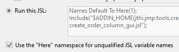

jthi
Re: Inconsistent acceptable syntax
Toolbars might be adding Names Default To Here(1) (which I say you should always have) to your script
which can then potentially show some errors which wouldn't be visible if everything is in global scope (but still they are usually errors). I build my formulas using either Eval(EvalExpr()) or Eval(Substitute())

toolbar icons know the  current data table():
The problem is rather the inverse one.
Please  define "dt=current data table()" before the
dt << Get Column Names();
