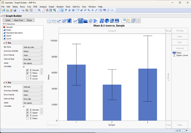

There are a couple of items that I had to do to make your data work.
First, in the Columns selection area, I added in 2 new virtual columns, Upper and Lower.  They were created to give the upper and lower values for the Mean+- Standard deviation.
Second, after dragging Mean, Upper and Lower to the Y drop area, I changed the points to a bar.  Since I only wanted the bar to represent the Mean value, I changed the Variables property and unselected Upper and Lower
Third, I added a second Bar to the graph.  I again when to the properties area, and changed the Bar Style to Interval, and since I only wanted Upper and Lower to be included in the Interval Bar, I unselected Mean
Here is the JSL to recreate the graph
Graph Builder(
	Transform Column( "Lower", Formula( :Mean - :Standard deviation ) ),
	Transform Column( "Upper", Formula( :Mean + :Standard deviation ) ),
	Size( 744, 627 ),
	Variables(
		X( :Sample ),
		Y( :Mean ),
		Y( :Upper, Position( 1 ) ),
		Y( :Lower, Position( 1 ) )
	Elements(
		Bar( X, Y( 1 ), Legend( 4 ) ),
		Bar( X, Y( 2 ), Y( 3 ), Legend( 6 ), Bar Style( "Interval" ) )
	SendToReport(
		Dispatch( {"Bar"}, "", OutlineBox, {Close( 0 )} ),
		Dispatch( {"Bar"[2]}, "", OutlineBox, {Close( 0 )} ),
		Dispatch( {}, "Y title", TextEditBox, {Set Text( "Mean" )} )
Note:  It would be much simpler to use the raw data to create the chart you want.  JMP would generate the mean, upper and lower values for you.

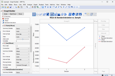

Here is one way to do this:

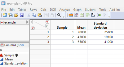

Give the data table
You can graph it:
Names Default To Here( 1 );
New Table( "example",
	Add Rows( 3 ),
	New Column( "Sample",
		Numeric,
		"Nominal",
		Format( "Best", 12 ),
		Set Property( "Value Order", {Numerical Order( 0 )} ),
		Set Selected,
		Set Values( [1, 2, 3] ),
		Set Display Width( 97 )
	New Column( " Mean", Numeric, "Continuous", Format( "Best", 12 ), Set Values( [70000, 45000, 65000] ) ),
	New Column( "Standard deviation", Numeric, "Continuous", Format( "Best", 12 ), Set Values( [25800, 19100, 41200] ) )
Graph Builder(
	Variables( X( :Sample ), Y( :" Mean"n ), Y( :Standard deviation ) ),
	Elements(
		Position( 1, 1 ),
		Points( X, Y, Legend( 5 ) ),
		Line( X, Y, Legend( 7 ) )
	Elements(
		Position( 1, 2 ),
		Points( X, Y, Legend( 6 ) ),
		Line( X, Y, Legend( 8 ) )
	SendToReport(
		Dispatch(
			"400",
			ScaleBox,
			{Legend Model( 5, Base( 0, 0, 0, Item ID( " Mean", 1 ) ) ),
			Legend Model( 6, Base( 0, 0, 0, Item ID( "Standard deviation", 1 ) ) )}
		Dispatch(
			"400",
			LegendBox,
			{Legend Position( {5, [0], 7, [2], 6, [1], 8, [3]} )}
Do you have a graphical format that is different than what I demonstrated?  If so, please provide it, and the Community will jump in to help you with that.

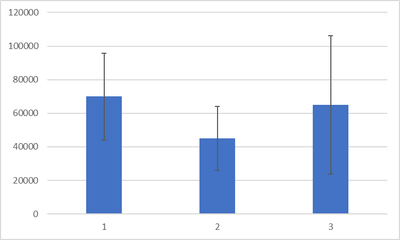

Anyway to graph it similar to below:
Thank you!
Graph Builder(
	Size( 744, 627 ),
	Variables(
		X( :Sample ),
		Y( :Mean ),
	Elements(
	SendToReport(
