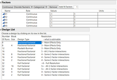

As a general remark, the higher the resolution, the higher the number of runs required, so you need to evaluate the tradeoff between what you want to discover/evaluate and your experimental budget constraint. Also depending on the construction and type of classical design (fractional factorial, Plackett-Burman or others) you may not have a lot of flexibility on the run size step/increment (as an example, here is the possible designs list for 5 factors from the 2-levels screening design platform) :
You may find a higher flexibility in run size, model specification, and better handling of constraints by using the Custom Design platform.

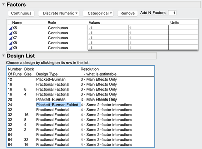

Thank you for these explanations. The reason I was asking about the Plackett-Burman Folded is because I get this as one of the options when attempting to design a screening DOE:
Therefore, I was curious about the added value of the P-B Folded when compared to P-B and FF design.

Hi @SaraA,
Ok I understand better your question and the design mentioned.
The 24-runs option "Plackett-Burman Folded" you see corresponds to a foldover of the first design PB (resolution III) shown in your screenshot (with 12 runs).
You can reproduce the 24-runs Plackett-Burman Folded design highlighted by using the 12-runs Plackett-Burman design, and then augment the design using a foldover (without specifying a factor for the foldover). You'll then see that the new 12 runs added to the original PB design are just mirror experiments (levels are inversed between original experiments and new ones, -1 instead of 1, and 1 instead of -1), in order to uncover aliasing and enable identification and estimation of some 2-factors interactions.
About centre points, 3 to 5 is usually a good range, as it enables to detect quite precisely curvature, without biasing the lack-of-fit test with too much centre points experiments. Please remember that adding centre points may help in detecting curvature, but you won't be able to link this curvature to specific quadratic effects of your factors. You will only be able with centre points to fit one quadratic effect among all that may possible.
