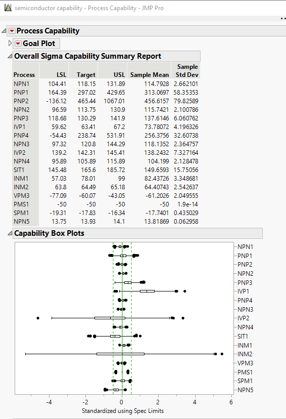

Hello,
I would like to replicate the following graph using JMP. particularly the rightmost column. (the graph column - not SpcYld)
I've looked through the various platforms, and i feel like i must be missing something.
Thank you very much

The Process Capability platform provides most of what you want.  Within the current capability, it provides all of what you want except the Units and Median values
By default, the top table provides many more values, but I right clicked on the table, and removed all of the columns that were not specified in your example.
Some fairly simple scripting could add in the Units and Median columns.
