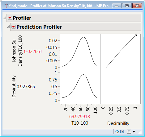

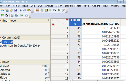

Once you have used Distribution to fit the Johnson Su distribution to your data, you can choose Save Density Formula from the Fitted Johnson Su menu.  This saves the Johnson Su Density formula to a column in your data table.
Next you can open the Profiler by choosing Graph>>Profiler.  Cast your density formula as the Y, Prediction Formula and click OK.  Next turn on the Desirability Functions from Prediction Profiler menu.  After that you choose Maximize Desirability from the Prediction Profiler menu.  This will find the mode (maximum) of your Johnson Su density for this data.

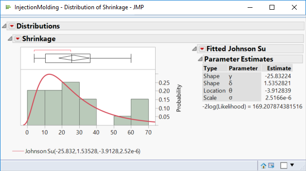

  1. I opened the Injection Molding example from the Sample Data Directory.
  2. I opened the Distribution platform on the Shrinkage data column.
  3. I fit the Johnson SU distribution to obtain the Johnson SU parameter estimates.
  4. I wrote a script with two steps outlined above to find the peak location.
Here is the fitted distribution:
.The script is:

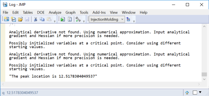

Here is the result in the Log:
Don't be alarmed by all of the messages - it worked just fine! You can see the result at the bottom.

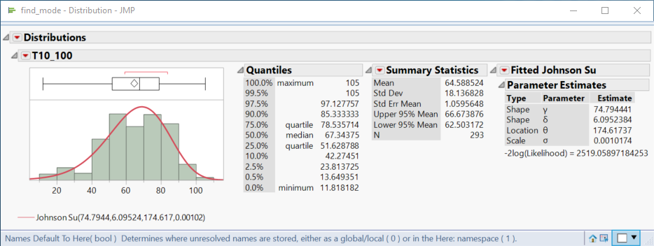

I am not having any problem with the data in this column. Here is a new version that avoids having to manually enter the parameter estimates, borrowing from Ian's solution:
Names Default to Here( 1 );
dist = Current Data Table() << Distribution(
	Stack( 1 ),
	Continuous Distribution(
		Column( :T10_100 ),
		Horizontal Layout( 1 ),
		Vertical( 0 ),
		Fit Distribution( Johnson Su )
estimates = Report( dist )["Fitted Johnson Su"][NumberColBox(1)] << Get As Matrix;
dist expr = Substitute(
	Expr(
		Johnson Su Density(
			q,		// quantile
			ggg,	// gamma or first shape parameter
			ddd,	// delta or second shape parameter
			ttt,	// theta or location parameter
			sss		// sigma or scale parameter
	Expr( ggg ), estimates[1],
	Expr( ddd ), estimates[2],
	Expr( ttt ), estimates[3],
	Expr( sss ), estimates[4]
peak height = Maximize( dist expr, { q( 0.01, 70 ) } );
difference = Minimize( peak height - dist expr, { q( 0.01, 70 ) } );

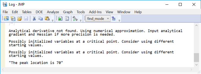

Print( "The peak location is " || Char( q ) );
I get this result with your data:
So it is not the data or the script, it must be JMP (installation).
