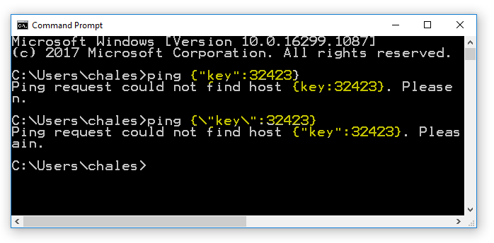

Here's my attack on the problem; I used the dos ping command because it sent back a nice message:
The second command escapes the quotation marksThe second command escapes the quotation marks
I think you can do this in JMP like this:

The escaping in the JMP log is confusing, the program sees what you are hoping for. Try this write statement to make the escaping in the log go away:
my_str = ["key" => 32423];
json = As JSON Expr(my_str);
quote="\!"";
escapedquote = "\!\\!"";
txt = runprogram(executable("ping"),
	options({substitute(json,quote,escapedquote)}),
	readfunction("text"));
write(txt);
Ping request could not find host {"key":32423}. Please check the name and try again.
Craige
