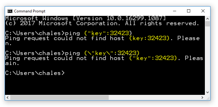

Here's my attack on the problem; I used the dos ping command because it sent back a nice message:
The second command escapes the quotation marksThe second command escapes the quotation marks
I think you can do this in JMP like this:
