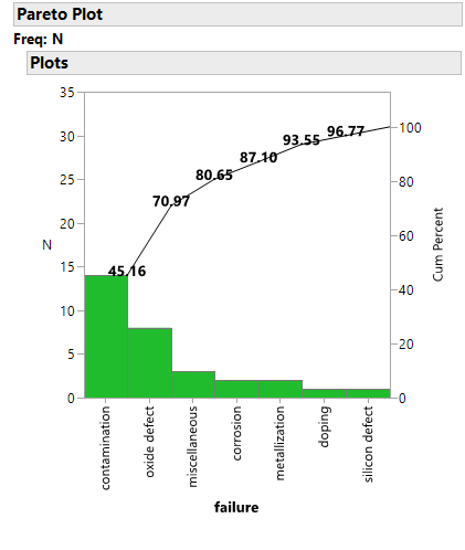

Does anyone know if it is possible to change the formatting of the cumulative % label in the pareto plot?

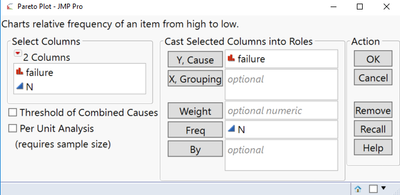

This was made using the Failure.jmp sample data table and Analyze --> Quality and Process --> Pareto Plot as shown below

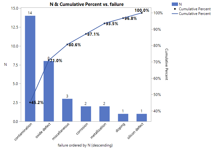

Does your request refer to text fonts or to data formatting or both?  You can create a Pareto Plot with GraphBuilder. It requires that you create a cumulative sum column, but in return you can customize both font and data format and even more with Hover Labels if you want even more features.
The script below (and attached) hopefully is self explanatory. it creates two plots.  Note they are journaled, since to create the cumulative sum column, the table needs to be sorted and the Quality and Process Pareto plot needs to be closed to do so.
Note the Font of the cumulative labels, is Text Font() for the Pareto report and Graph Label() for Graph Builder report.

//do this with GraphBuilder
 //new column to be used with GraphBuilder solution
//first Sort Table
dt << Sort( By( :N ), Order( Descending ), Replace Table );
//create a column of cum percent with preferred data format
pct = dt << New Column("Cumulative Percent", Numeric, "Continuous",	Format( "Percent", 10, 1 ),
 Formula(Col Cumulative Sum( :N ) / Col Sum( :N )));
dt << Set Label Columns( :Cumulative Percent );
dt << Select all rows();
dt << Label(1);
dt << clear select;
 //change font if preferred for Graph Builder this is Graph Label
 glabelpref = Get Preferences(Graph Label);
 Set Preference(Graph Label("Segoe UI", 10, "Bold"));
 wait(0);
gb_pplot = dt << Graph Builder(
	Size( 534, 475 ),
	Show Control Panel( 0 ),
	Variables(
		X( :failure, Order By( :N, Descending, Order Statistic( "Mean" ) ) ),
		Y( :N ),
		Y( :Cumulative Percent, Position( 1 ), Side( "Right" ) )
	Elements(
		Bar( X, Y( 1 ), Legend( 14 ), Label( "Label by Value" ) ),
		Points( X, Y( 2 ), Legend( 12 ) ),
		Line( X, Y( 2 ), Legend( 13 ) )
gb_pplot << Journal;
gb_pplot << Close Window();
