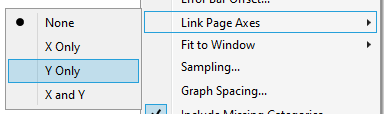

Is there an option in Jmp to synchronize/link the axes between the different parallel values, like it's possible to link axes between different pages?
I can't reproduce a graph like yours without a version of your data but try right clicking on the axis label and trying some of the other Combine Scales options to see if one of them gives you what you're looking for.
Hi @Jeff_Perkinson , thanks for helping to find a solution :) Combine Scale sounds like the right place to look at ... Unfortunately, none of the generated plots looks like expected, i.e. same values on the same height, indicating horizontal line ~ no bin flip

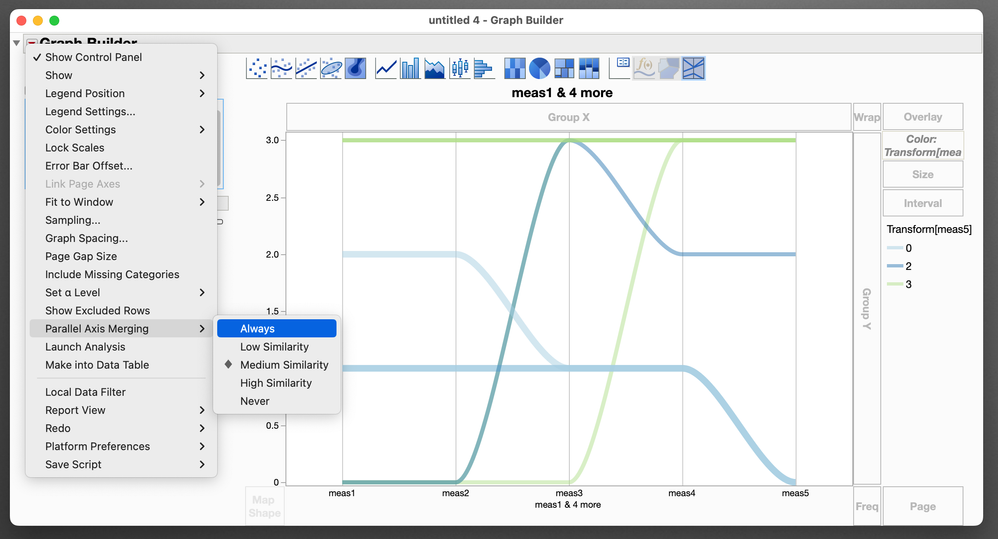

If you want to ensure the same axis for all variables in a parallel coordinate plot, you'll want to have your variables as continuous (and a proxy variable if you're using one of them in another role, like color):
If the scales are very different, you will also need to instruct Graph Builder to always merge parallel axes, which is an option you can find under the Red Triangle while holding shift:
If you select "Always" for Parallel Axis Merging, then regardless of how different the scales are, Graph Builder will use a single scale for the Y axis rather than implicitly standardizing the space.
