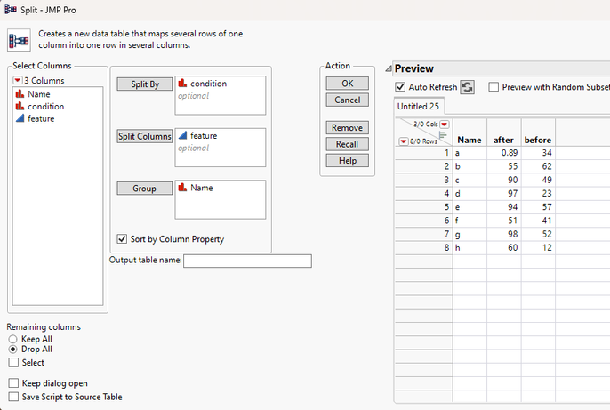

Go the Split Platform     Tables=>Split
Fill in the Split By, Split Columns and Group boxes, and Click OK and a new transformed data table will be created.

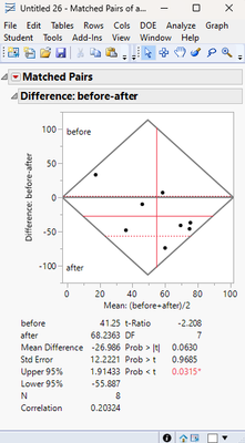

You then can run the Matched Pairs

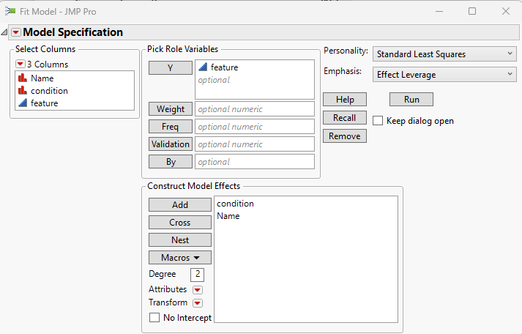

There is an old school method for performing the Matched Pairs analysis by using Anova.  If you run Fit Model, and specify both the Condition and Name as factors

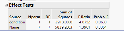

You will get the same result.
F = t squared
F= 4.8752 = -2.208^2 = t

I confirmed the Split By function. More importantly, I confirmed that even if you have several features (feature1, feature2, etc), the Split By function will split all of them (into for example "feature1 before", "feature1 after", "feature2 before", "feature2 after", etc). Then, you can run the paired t-tests on those columns.

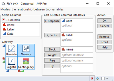

Here is a way to run the analysis on the tall table using Fit Y by X. In this case, use Data as Y, Label as X, and Name as the Block:

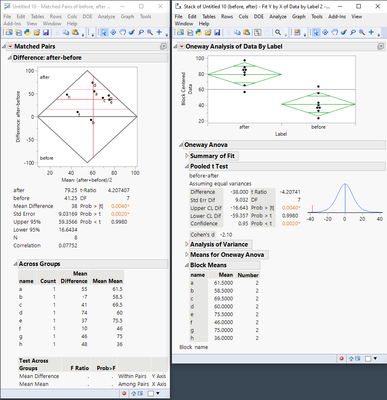

The summary statistics are the same, but the reports are different.
